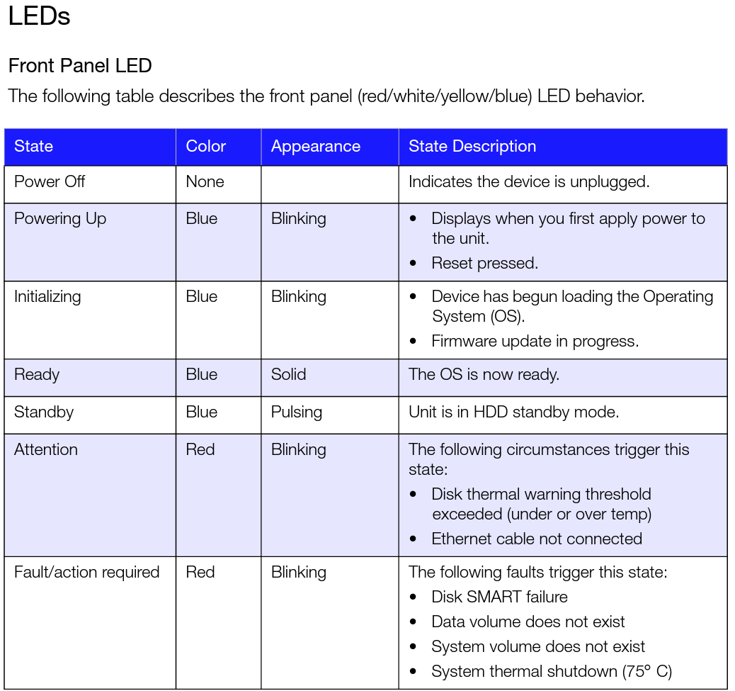

Some WD Support Articles that may or may not help.
My Cloud: Blinking Blue Drive LED
Blinking White or Blue Power LED on My Cloud
What Do LED Blinking White, Blue, or Solid Amber Mean on My Cloud?
If you haven’t done so already, try searching for past discussions on blinking/flashing blue front LED. There are quite a few posts and discussions about it both in the OS5 section and OS3 section. A few deal with the issue occuring when trying to flash from v2.x firmware to v5.x firmware. Could be a suggestion in one of those other posts may help.
OS5: http://wdstagingsplit.staged-by-discourse.com/search?q=blinking%20blue%20led%20%23os5
OS3: http://wdstagingsplit.staged-by-discourse.com/search?q=%23personal-cloud-storage%3Awd-my-cloud%20blinking%20blue%20led
http://wdstagingsplit.staged-by-discourse.com/search?q=blinking%20blue%20led%20%23os3
