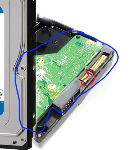

Again this caused the need to detach the HDD, check the cables again, and after some time the main issue happened, the L shaped attachment for SATA, the plastic that holds the pins broke… I didn’t use much strength more strength than i did before, i have 2 other WD HDD which have more than a decade, and nothing like this ever happened, i detach them when i clean the pc but now a brand-new HDD and something like this happens after a week.
Now, if i wouldn’t have any data there, i would simply demand a replacement, but because i have it, now i can’t send the HDD for replacement, and i know very well that the data has to be sanitized to make it nearly unrecoverable.
I see there’s a separate piece that can be screwed off and replaced, in this way i could attach it, sanitize the data, and send it for replacement.
I add an image showing what’s broken in red and what i suspect could be replaced in blue.
I should demand from WD to send me a piece like this, or at least buy it somewhere else so i can properly attach the HDD and remove the data.

Hi @diego77,
Please refer to the article Recover Data from a Drive, Obtain a Circuit Board, Repair a Drive, or Find Data Recovery Partners:
Please contact the WD Technical Support team for best assistance and troubleshooting:https://support-en.wd.com/app/ask
