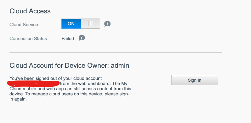

After to connect cloud account admin. I get the follow error.
“Something went wrong, please check that you have an active Internet connection and try again.
(error code: 1002)”
So no cloud access… Very frustrated…

What does your dashboard show? Are you signed in or not signed in? See example image below.

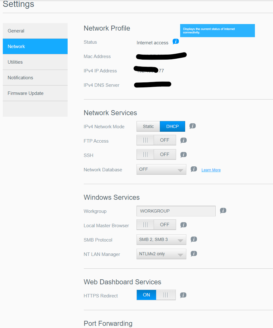

What is showing under Settings>Network? See example image below. Click on, tap, or activate image to enlarge it.
So turn the Cloud Service OFF, wait a few minutes, then turn it back ON and wait to see if the Connection Status indicates Connected. And one would also have to sign their account in via the Sign In button as well.
