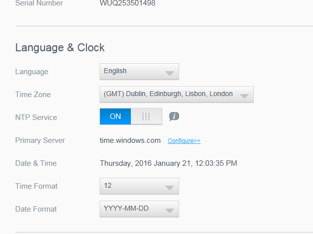

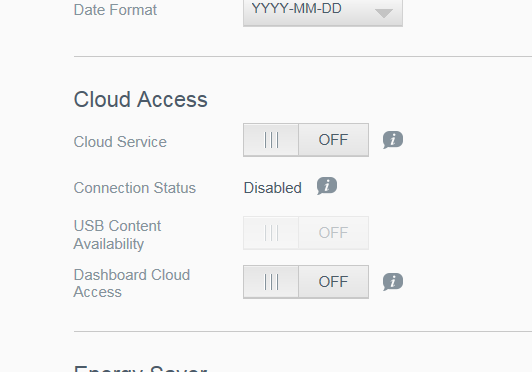

Question 3: The NAS primarily acts as a local network device. Yes it does offer access across the internet but you don’t have to use it and YES you can turn it all off. The main place to do this on the EX2 is via the dashboard. Go to the Settings page, under the General settings. About half way down you will have this:
Just turn them all off. It will still try and get the time from the internet, but that can also be turned off so you can set the time/date manually:

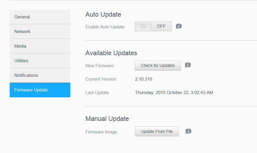

Still on the Settings page I would also go onto the Firmware settings and turn off automatic updates:
Those are the main things that will cause the EX2 to try and access the internet.

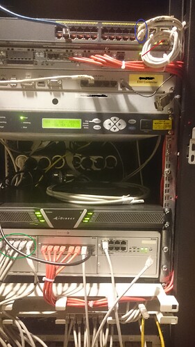

HOWEVER, i decided to unplug a cable in our switch, and connect the NAS there. It immediately showed up on the “network” in My Computer, but the power light on the nas turned orange and started flashing. I didn’t get to access it either, it just shows up and gives me: “Windows cannot access WDmycloudEX2 please check that the spelling is correct and yattayattayatta,- Diagnose”.
I’ll throw in some pictures with “explanation” of our network, not that i understand that much myself though.
From the center of the picture, you can see the Idirect X7, that’s our main modem. The modem is connected to a cisco catlyst 2960, as marked with the blue circle. from there, a cable goes from the 2960, to another cisco device, this is marked with a red line. From there, you an see red cables that run down to the next switch, this one is named Alcatel-Lucent I believe. If you can see the black cable plugged in to the right of the red cables, that’s the EX2.
After plugging it into this switch it immediately showed up on our network but we can’t access it there or in the browser. The cables to the left marked by green circle go down to each cabin and to the wifi extender (the modem doesn’t provide wifi itself, so we have a sonicwall wifi router.)

I’m not quite sure of the purpose of the Cisco 2960 switch at the top unless there is another device which needs to connect directly to the Idirect X7, but not via the firewall. At least that is all I can think of. The other thing I notice are all of the red cables which seem to come down from the Cisco firewall (I can’t make out the model of that in the pic) to the lower switch. What I’m wondering is if there is a more complex set up such as VLANing between the ports on the lower switch with the red cables plugged in, and the ports to the left with the cables for the cabins plugged in to seperate the traffic between them in some way. Usually (if done sensibly) the red cables will be red to differentiate them for a reason - but I could be wrong. One possibility would be, if other ship-board systems also require internet connectivity, would be to provide a degree of isolation between normal crew “browsing” activities and critical ship-board system traffic to protect the critical stuff.Again this is just a guess but would make sense if such systems are connected.
Many companies, where I work included, for instance provide internal WiFi which connects company devices to the internet and company data/servers, and a “guest WiFI” to provide isolated internet for employee devices (phones) and visitors (clients etc) while protecting the internal network.
Just in case that may be the situation, is there a free port on the section where the cabin cables are plugged into where the EX2 could be connected instead of beside the red cables?
A clearer picture of the bottom switch could help.
Anyway give that a try to see if you can get into the browser interface that way. If that works we can then take it from there.
