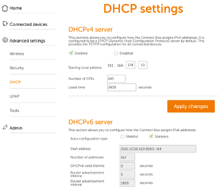

Additional info about my home network: I have a WiFi modem supplied by my service provider (Vodafone/Ziggo, Eurodocsis 3.0). That modem is wired to my WiFi router (Apple AirPort Time Capsule). The NAS is connected to the Apple router via UTP. Router mode is disabled on this router (in bridge mode). The settings on my service provider’s modem are:
The shown IP address is the address of my NAS.

Thank you for your comment! Following a tip from my ISP, I made some adjustments in my router settings: disable UPnP and add port forwarding rule based on the internal IP address of the NAS. This solved the issue for me. I did not have to make any adjustments in the NAS itself.
