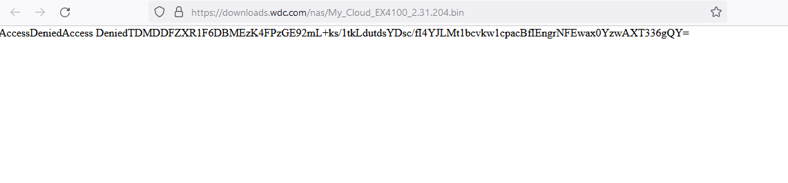

Tried to download 2.31.204 but access denied:
No luck…
