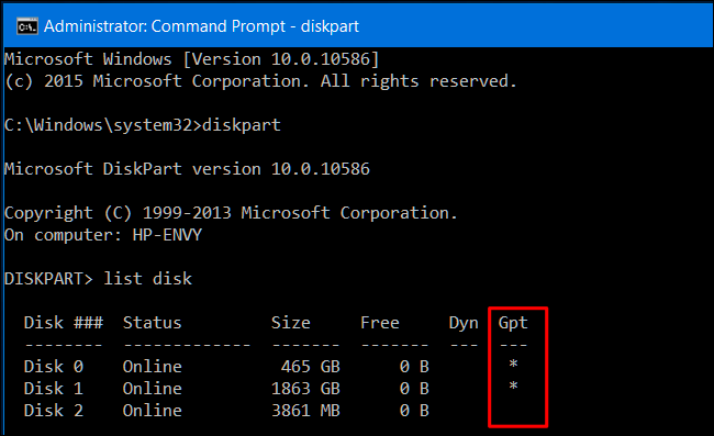

To find out if it is GPT …
Press your Windows Key + R … then type cmd and then diskpart and then list disk
Look under the Gpt Column … if you see a * next to the disk, then it’s GPT
example:
