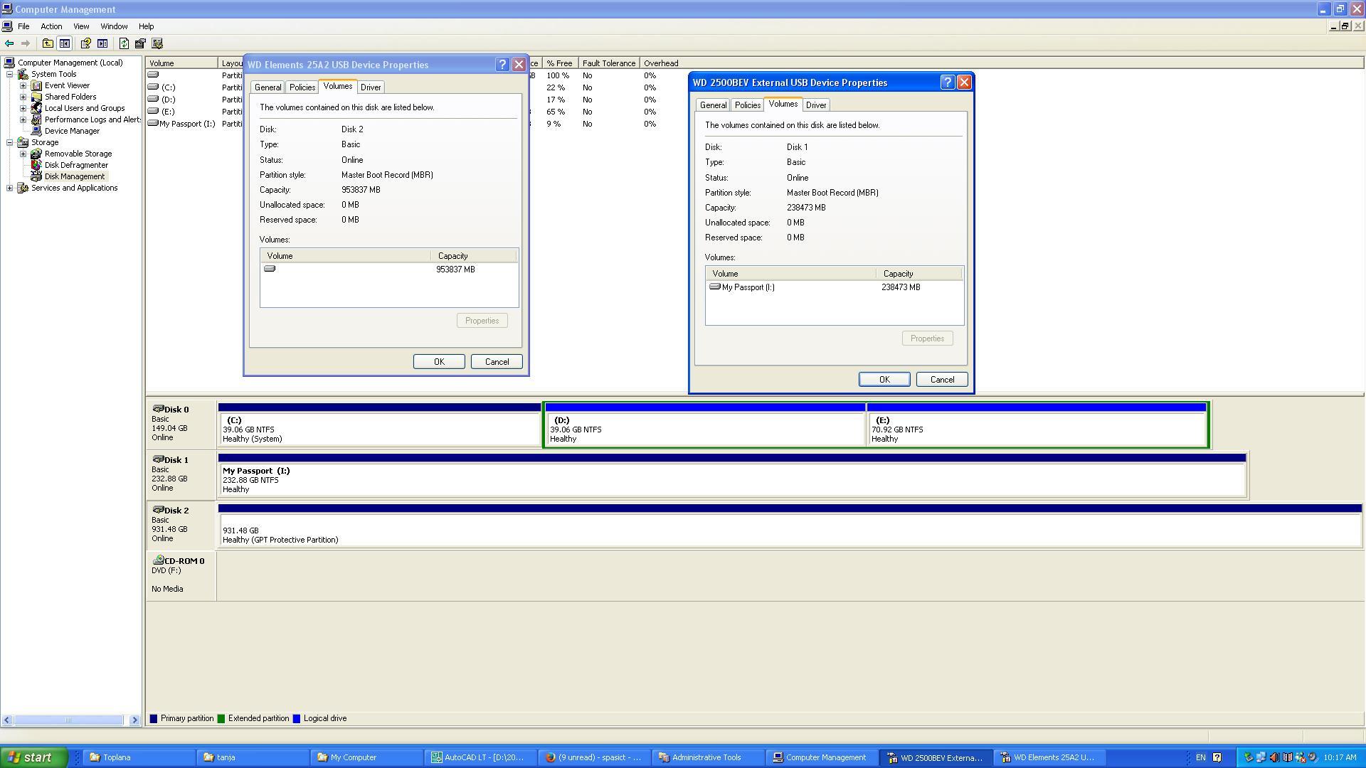

Hello Again
I sent you a picture. I think it’s easier to understand. Left WD Elements does not work.And right is working

That picture doesn’t make a lot of sense … (how can Disk 2 be GPT and MBR at the same time ? not possible)
