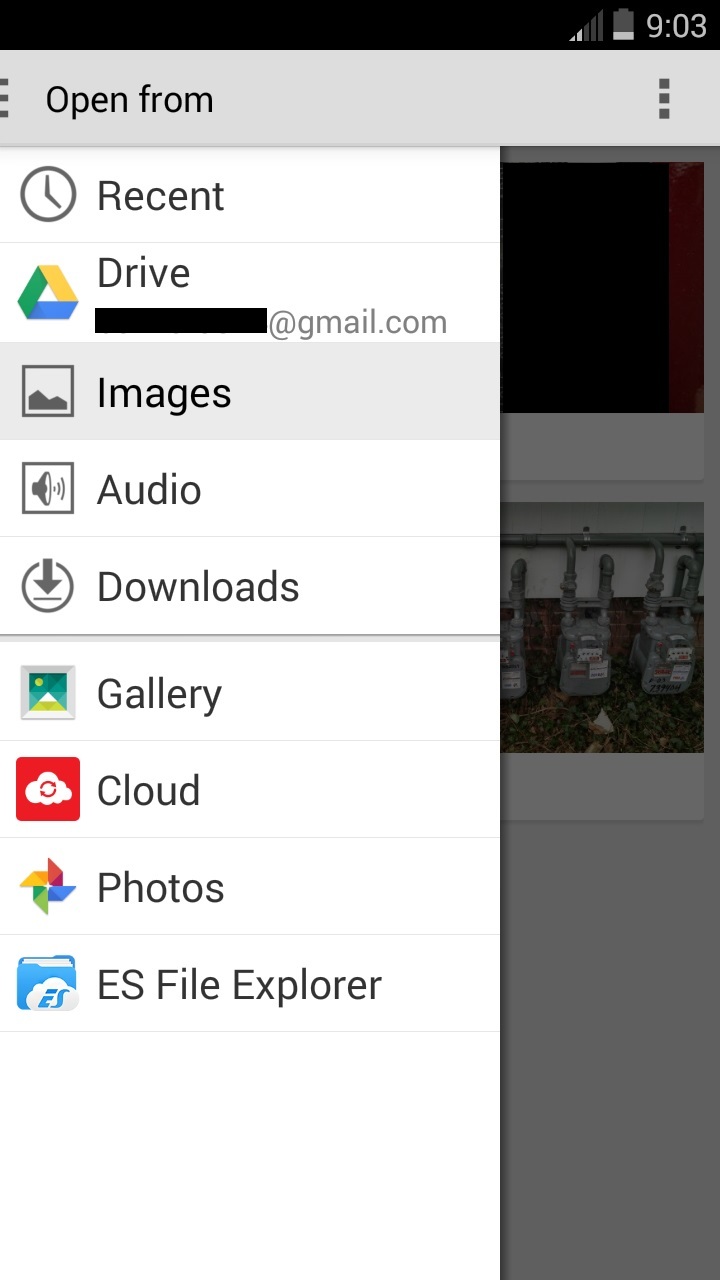

It may be possible that once the file manager is installed it will allow the email application to use the file manager program to access the My Cloud and attach a file to the email.
On the Android, with ES File Explorer installed, the stock email app will list that app as one of the options for the attachment option. I can then use the ES File Explorer app to access the My Cloud and attach a file to the email.
