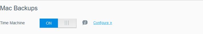

Make sure to enable, set to ON, the Time Machine option in the My Cloud Dashboard > Settings > General > Mac Backups section. And make any changes needed by clicking the Configure link. Examples from a first gen v4.x firmware My Cloud :
