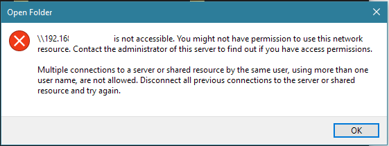

This issue with Windows has long plagued My Cloud users. One ususally gets a error like this:
Most times its due to trying to use a second (or third) User/Password to access a Private Share on the My Cloud. Windows doesn’t like users using more than one username/password to access Shares on an NAS (for what ever reason). The workaround is to use a My Cloud User that has permission to access all the Shares one wants to access.
One may have to delete all My Cloud entries in the Windows Credentials Manager and remove/delete all mapped My Cloud Shares too. Then reboot the computer to clear certain Username/Password is incorrect errors when accessing a My Cloud Private Share.
