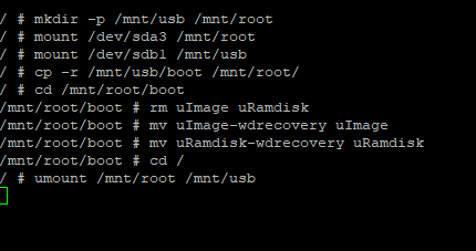

I followed all the instruction. Telnet to MyCloud. But got stock at command
“umount /mnt/root /mnt/usb”, it’s just sitting, frozen there.
Did I mess it up? I would appreciate your help. Thank you

After the first freeze, a couple of times I tried it rebooting, and follow the same process again. It would reboot, I would get the yellow & red lights. I would type the lines of code, but as soon as I got to and typed “umount /mnt/root /mnt/usb”, and pressed “enter”, the cursor would jump to the next line and just stay there, with no “/ #” prompt. After the last attempt, I could not Telnet to the NAS box anymore, so I gave up.

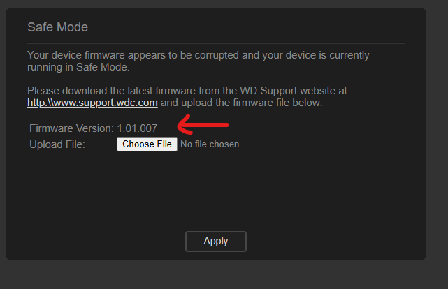

After that every command executed properly, without any warnings or errors, the box reboot, I unplugged the power plug and the USB, and re-plugged the power, it went to blinking blue, after about a minute it went to red, IP had changed, Once I went to the browser with the new IP, it produced the following window:
Issue 2 - Firmware update:
I went to firmware page the latest version is: Firmware Release 5.29.102 (04/24/2024), with a warning *" My Cloud OS 3 firmware 2.42.115 must be installed before updating to My Cloud OS 5 firmware.
**Some features and apps from My Cloud OS 3 will not be available with My Cloud OS 5. Before upgrading, please review this Knowledge Base article for more details".
Is my current Firmware Version is 1.01.007, based the screen capture above?
Finally, what firmware update do I use.

That safe mode page where you install the firmware is what you are supposed to get. Start by installing the latest (last) 2.42.115 firmware. After flashing check the My Cloud Dashboard to see if it is working properly and if there are any diagnostic errors. It is usually recommended that one do a 40 second pin reset after successfully flashing the initial v2.x firmware after getting that safe mode page.
Once you verify the My Cloud is operating normally you can, if you so choose, update to v5.x firmware from the v2.42.115 firmware. Note that more than a few have chosen not to update a singe bay second gen My Cloud to v5.x firmware due to various performance issues that model suffers under the v5.x firmware. Search the subforums (including My Cloud OS5 subforum) to see the issues and complaints about OS5 v5.x firmware.
