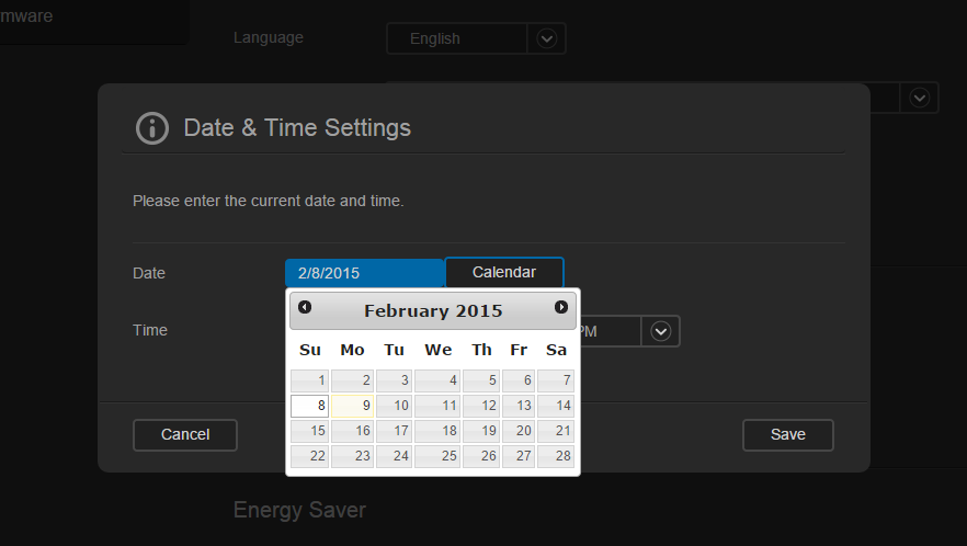

  1. DATE TIME
The date time manual config UI under Settings is buggy. If I try to manually set date after disabling the NTP, no matter what date I pick from the calender, when I click Save button the date of previous day is selected. example if I select 9th feb and click Save then 8th feb is updated to the system.

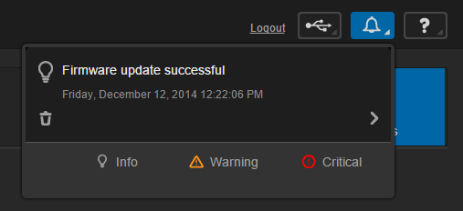

  1. NOTIFICATION DATE TIME
Notification in the UI always shows wrong date time. I just updated firmware today and its showing notification of firmware updated on ‘Friday, December 12, 2014 12:22:06 PM’!

For your question #1 what time zone do you have set under Settings>General>Language & Clock>Time Zone?

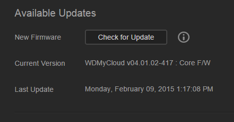

For question #2 what is showing under Settings>Firmware for Last Update?

 Issue 2
I note that the reported date is very close to the release date of the latest firmware, which was announced 17-dec-2014, but contains a .deb file dated 11-dec-2014.  It wouldn’t surprise me if this .deb name is wrong, and the actual build date is 12-dec-2014
So I’m guessing that the reported firmware update date is the build date of the image, not the date when the update was performed.
I’d need to check my machine to see what date it reports, but I might imagine a situation where the local time doesn’t ‘make sense’, so the timestamp of the build is used instead; for instance, if the local time is earlier than the build date.  Admittedly, that sort of check would seem out of character for WD, considering the lack of basic checks in other areas of the firmware
[edit]
Just checked, and, of course, the screen shot you posted is of the update process.  And I’m not going to do that just out of interest
The other place to check is Settings/Firmware/Available Updates, which shows the last update time.  In my case, it’s the time it was performed, not the build date.
I have UTC+0530 set. I tried even with just UTC and still had the same bug, in fact with just UTC the date would set to 2 days prior (if I set to 13 Feb with UTC time zone and click save, date would be set to 11 Feb).
For the second bug, check image below. I have seen notifications that show date 1 day in future too (i dont have it to take screenshot but, if notification occurs today then it shows tomorrows date in the notification)
