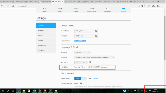

I am able to set time correctly. But not the date.
When I pick the calendar tool to set the date, the calendar shows the WD
date (wrong date) and Correct date (Probably it is picking that from the
computer) as highlighted. But when I pick the correct date ( any other date
for that matter) doesn’t get reflected on the system.
When I attempt to change to any other time zone, the date also get changed,
but still 1 day off for the new time zone.
My guess is that, somehow, the internal clock, which gives GMT time is
running one day off and something is preventing from updating it.
Mean while I tried first level system restore, but not of any use.
Please see screen shot of the UI attached along with.

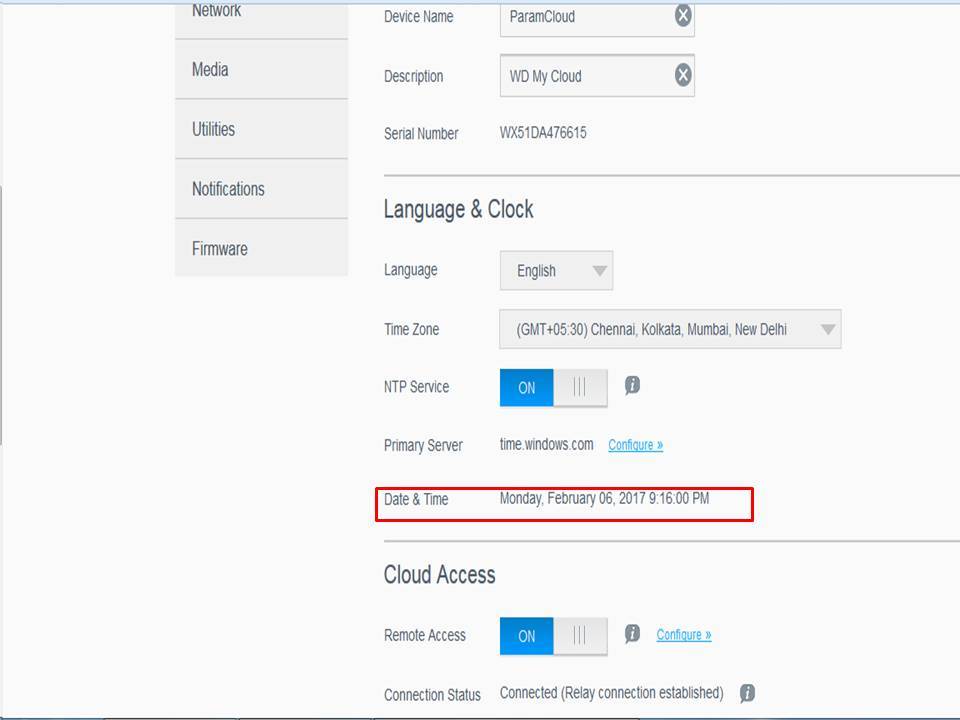

Hi Bimal

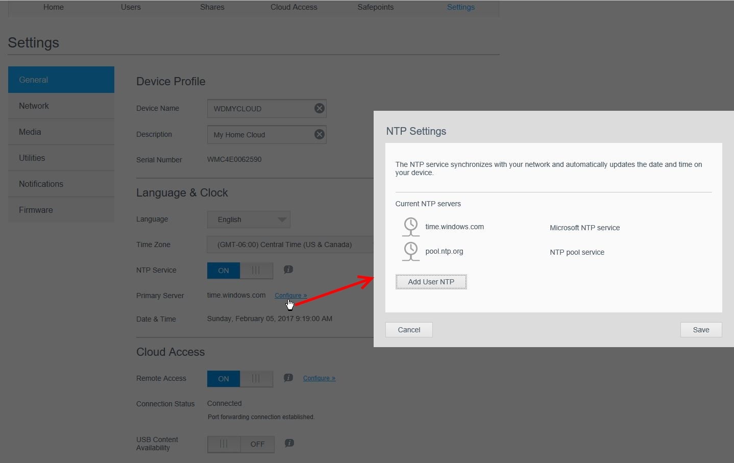

I am running my WD cloud in the same time zone and it seems to be working fine. Here is the screenshot of my cloud
In the screen shot, NTP Service is set to off, any particular reason you have it set to off?
Enable NTP Service then see if the time syncs. One can also add their own time servers by clicking on “Configure” to the right of Primary Server.
Also check your local network router to see if it is using the correct time just in case the My Cloud is pulling the time information from your router.
Dear Bennor,
NTP was set off, because it was not working.
It was not syncing to right date and time even after keeping it ON for
days. It was always connected to internet. The system was able to check the
firmware update, and that means, it was able to communicate to internet.
Do you think it is an issue with the hardware?
