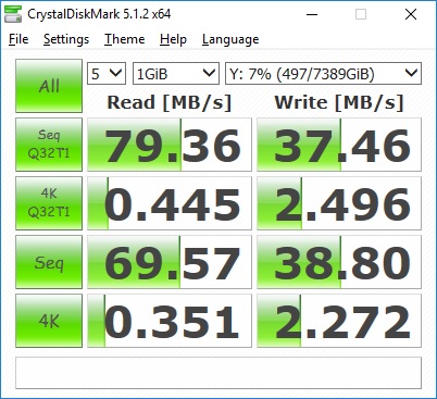

Here is one example of copy speed from one of my PC’s to the My Cloud over a gigabit connection.
If possible use various computers to test copy speeds, it is possible there may be an issue with the one computer or with the cabling between that one computer and the router the computer/My Cloud are connected too.

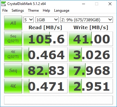

Here is a few examples of my speed using different hardware to a single bay v4.x My Cloud on my local network. It shows (at least in my case) how different network hardware (router) can affect network speed between one computer and the My Cloud.
Through my ISP router (Arris NVG589) from a desktop PC with a 1GB wired connection.
Through a Asus RT-AC86U router from that same desktop PC with 1GB wired connection.
