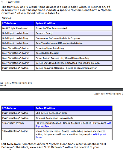

fast blinking LED may be a problem with the drive. See below from the user manual. I would sugggest contacting wd support
