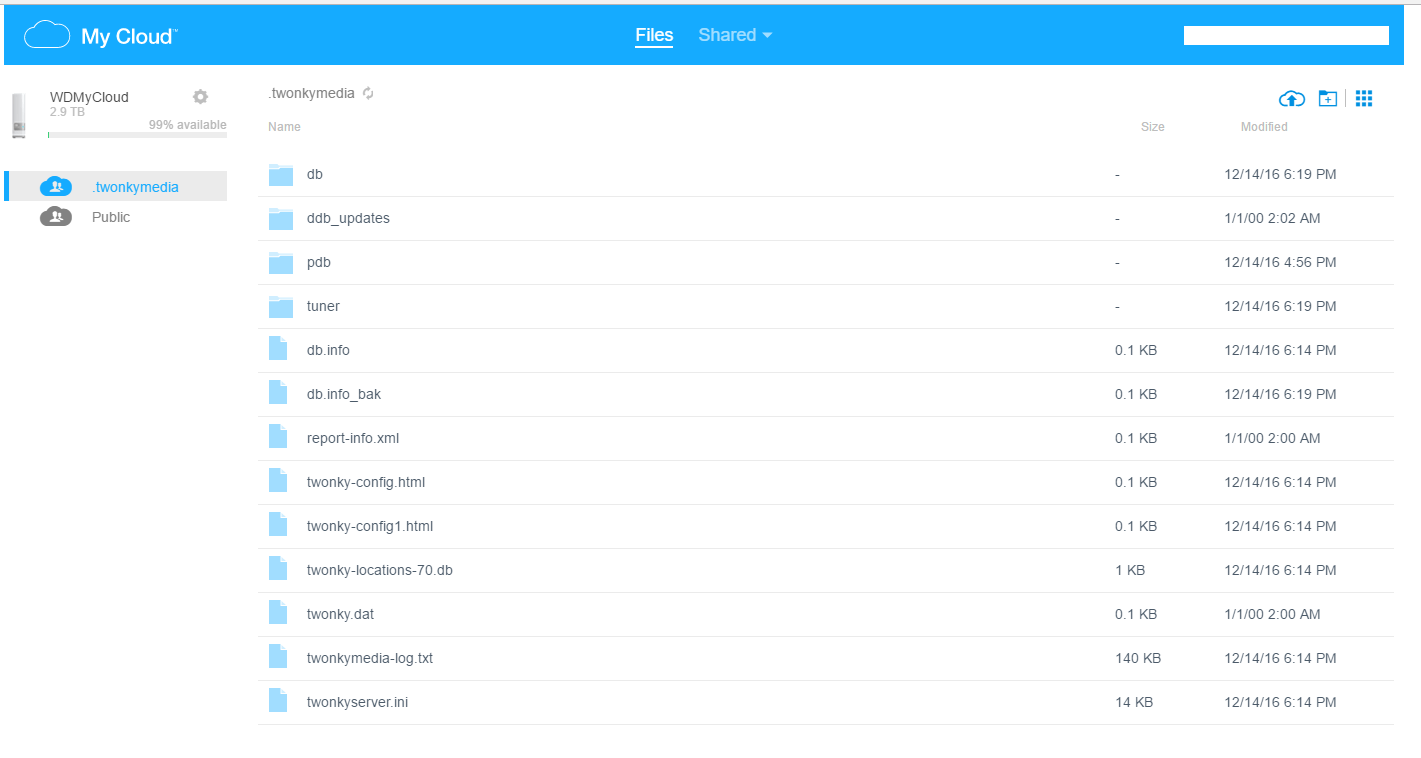

Finally after all this i see the screen attached.
1)What is the .twonkymedia folder and why is it there?
2)Where is my private folder etc?All i see is a public folder/
3)How can i create folders outside the public folder there is no option as i can see.
Sorry for the long post and the frustration. I would appreciate any help.

Not sure why the .twonkymedia folder is showing that is supposed to be hidden. Perhaps you should perform a 40 second reset and start the setup process all over again using your web browser to access the My Cloud Dashboard.

The .twonkymedia folder is for the Twonky DLNA media server. I don’t know why it’s now visible in ‘User space’, as it’s a system utility, and has been hidden in ‘System space’ on previous models and firmware releases. (The HDD is split into partitions to support the MyCloud NAS system, and for User data storage; the User isn’t normally allowed to see the System partition, so they can’t go deleting files and breakign the embedded linux system used to create the NAS).
Bennor has just chipped in; I’d agree with his suggestion to do a 40-second reset. Something doesn’t look right with your setup. If you’ve just bought it, and have no data on it, I’d be tempted to do a Quick Factory Restore (from the Dashboard).

All this that i wrote i forgot to mention were after i did a hard reset. Now i did a quick factory restore since i had no data in yet and it seems better now. The .twonkymedia folder is not there anymore.
