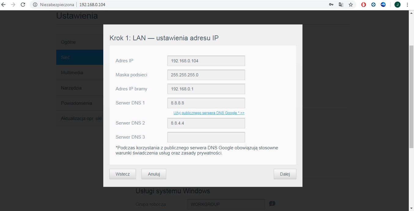

UPDATE: 1 hour ago i was trying to connect via Android app and it was working. Now i get error “Network connection failure 905”. I have no idea what is the reason, because MyCloud connected with static ip.

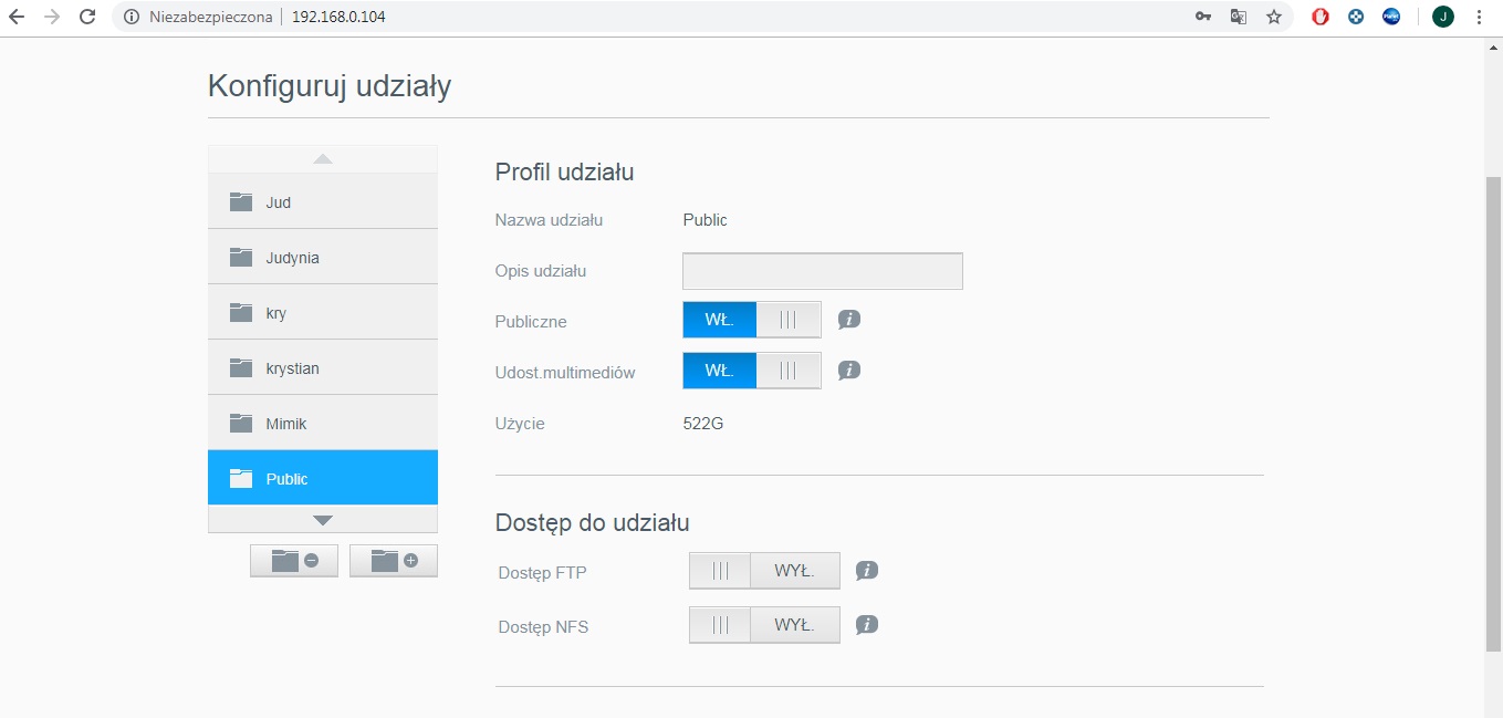

I think I know what is the reason of all problems - I can’t change accessibility to shared folders on MyCloud. All folders have public access. If I try to change folder from public to not public, i disable public option, going to second folder, changing public to disable, but after come back to first one it’s still public. It’s happening with all folders, doesn’t matter from user etc.
In my opinion there is a problem in software.
Also, all problems are connected. Attached photo of what I see after login to cloud.
on cloud there is something about 1tb of data, but everywhere I see 0mb. It seems that software doesn’t see what is on hdd.

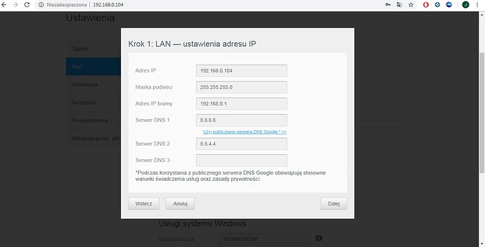

If possible don’t set a static IP within the My Cloud Dashboard. Rather access your router’s administration page and assign an IP address to the My Cloud. This way you shouldn’t run into issues with the My Cloud and another network device trying to share the same IP address.

It is often better to not set a static IP address in the My Cloud Dashboard > Settings section. Rather access the network router and assign or reserve the My Cloud IP address in the router’s DHCP server section. This avoids the My Cloud possibly having an IP address conflict with another device on the local network. When assigning an IP address via the router one would set Network Mode in the My Cloud Dashboard Settings to DHCP.
