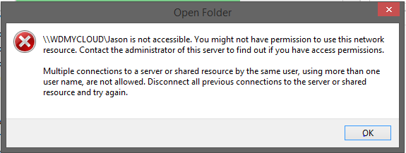

Tony hi,
This is the error message I get.
All help appreciated.
Thanks.
The second half of that error is indicating the issue.

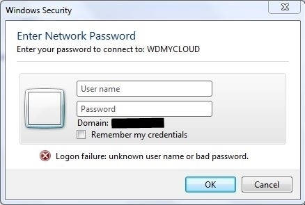

Reply to JASPINNEY,
Is this the sign in box you get when you try to open WDMYCLOUD or a share on the left side of the screen under Network? I only have to sign in when I am on my laptop as my desktop is the computer I set MyCloud up on.
Do you even get this or just the Open Folder warning?
Have you tried making changes in dashboard and then trying to open a share/folder?

SOMETHING is connecting to your Cloud via the PUBLIC credentials (basically NO credentials.)
Once that happens, Windows will prevent you from accessing ANYTHING that has non-public credentials.  It’s a stupid Microsoft limitation that NO OTHER O/S has.
For example, if Smartware is saving to a share that’s Public, it’s going to log in as Public, and that’s “All She Wrote.”
Here’s a test…
Instead of connecting via this syntax:
\wdmycloud\myshare
Try this:
\ip-address-of-your-cloud\myshare…  for example:
\192.168.1.100\myshare
If that works, then you know the above is the case.
If/when you get prompted to authenticate with a Windows login box make sure you type in wdmycloud\username where wd mycloud is the name of your mycloud (default is wdmycloud) and username is the mycloud user ID. Many times in Windows it will default to trying a domain or local computer user name. Specifying wdmycloud\username tells it to use the account on your mycloud.
thanks,
Travis
