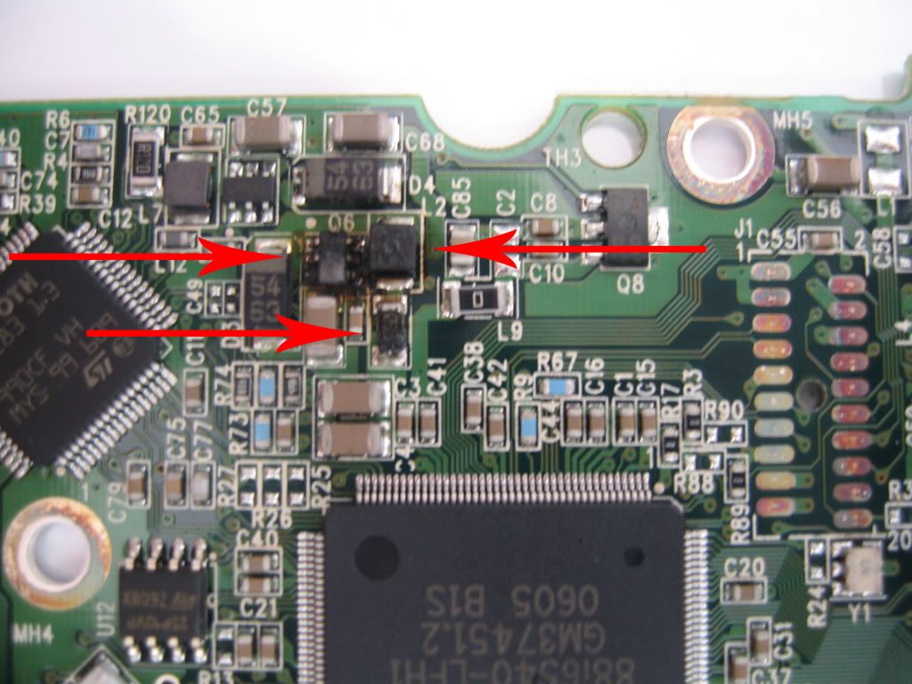

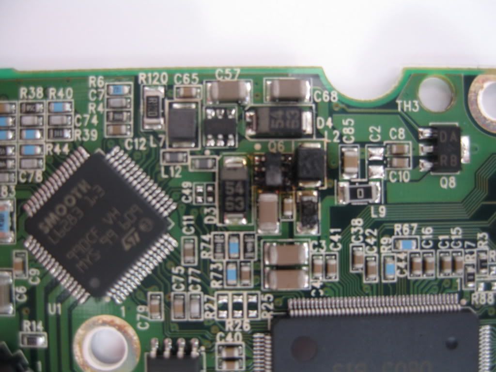

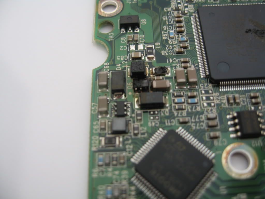

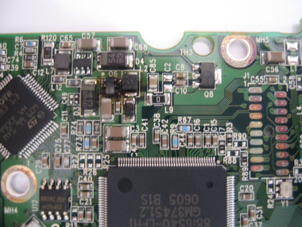

I have an external hard drive one of my dj’s could not find the plug so decided to use a universal one except it blew the circuit board on the hard drive, I believe the polarity was switched. I opened the the unit and removed the circuit board from the harddrive (Q6) is melted and a chip diagonal which does not have a number next to it. I have looked all over the web in search of a diagrag of the layout of the circuitboard with no find. I have 80,000 songs on here along with family photos. Please if someone could help.
If that is the case, then this board is beyond DIY repair. When replacing the board, you will most probably need to transplant the serial EEPROM chip (25P40VP) at U12 from patient to donor. This chip stores unique, drive specific calibration data.
The failed components (Q6, L2, and resistor?) in this photo …
… appear to form part of a switchmode regulator. I can’t see for sure, but I suspect that the junction of capacitors C3 and C4, and the resistor, is the Vcore supply (1.2V ?) for the MCU.
