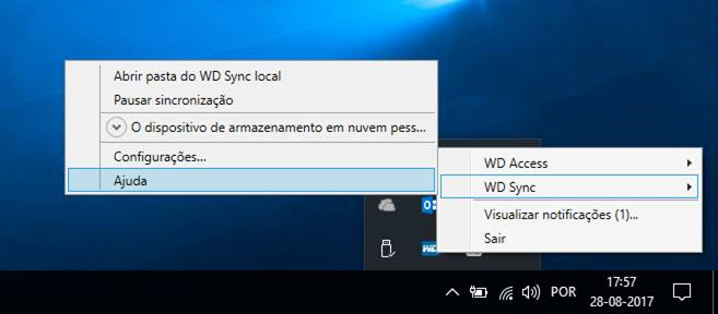

The WDSync program stopped synchronizing and does not connect to the disk in or out of the network where Mycloud is. The problem mantaisn even turning off the computer or restarting the application.
However, through the WD My Cloud software, you can access the disk.
This is being done from a computer running Windows 10. The WDSYNC Version installed is 1.3.5949. Sending status image:
