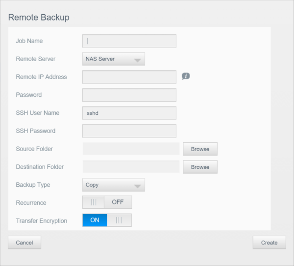

I have two WD My Cloud EX Ultra Devices and I have set them up so that one of them backs up folders from the other one (using the Remote Backups application).
The two devices are not on the same LAN (they are physically in different cities) and they both run My Cloud OS5 and their firmware version is 5.09.115.
The destination NAS device is on a network that does not have static internet (public) IP, so the public IP there keeps changing from time to time.
The instructions on WD website to setup the remote backup clearly state that there should be an option while setting up the backup job on the source NAS to obtain the IP address of the destination NAS using information in the My Cloud account (as the public IP address NAS of any NAS registered on a My Cloud account is communicated to WD servers). As per the instructions, this option should be available on the Remote backup Job configuration screen and labelled “Remote Server”.
Nonetheless and while this option is shown on the screenshots in the WD setup instructions, it is nowhere to be found on my respective source NAS configuration screen. It is just missing…!

Hello Bennor and many thanks for taking time to reply to my initial post.
Would you be so kind as to providing a link to the proper forum for my initial issue. I have been reading though Forum here and there and I have been unable to find an answer to the issue. Furthermore, I have forwarded the same question to the support team of WD only to receive a very general reply that I am to have a look at the same online article (Answer ID: 30036 - Steps to Setup and Use Remote Backups on My Cloud OS 5) which I had already studied inside out. Nevertheless, my question was never answered and this article seems not to be applicable for OS5.
The above screenshot is included in Answer ID: 30036. Nonetheless, the second option (Remote Server, with the drop down selections) seems to be missing from the Remote backup application in OS5…
