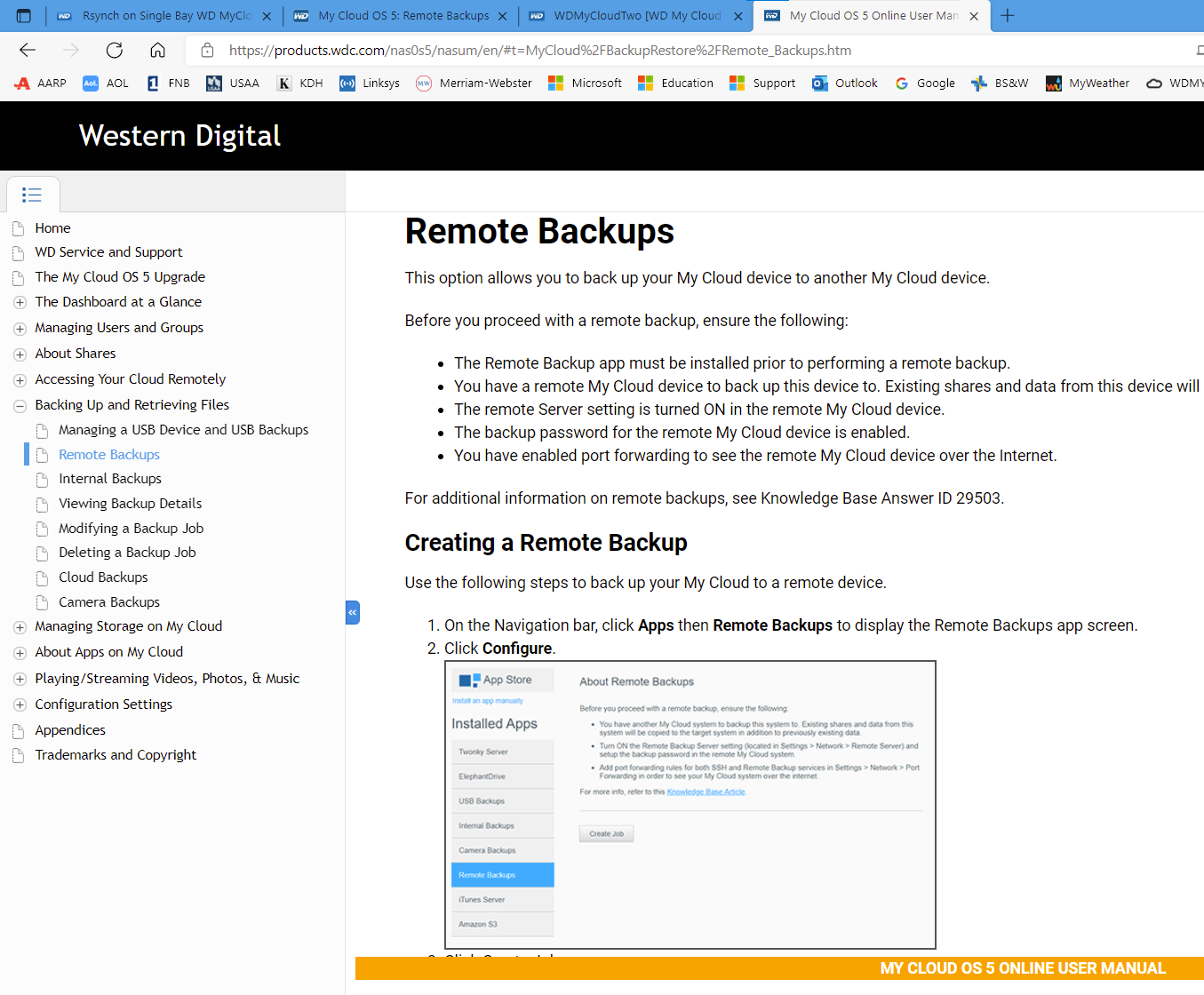

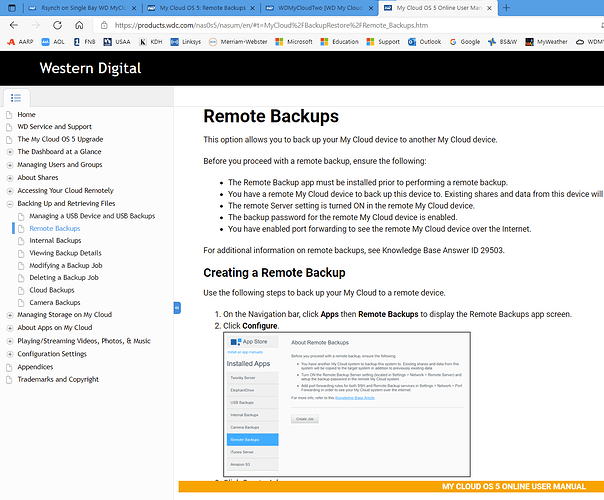

Have you installed the Remote Backups app? Does the destination My Cloud have Cloud Access?
Have you looked at Help in the Dashboard for Remote Backups?
My Cloud OS 5 Online User Manual (wdc.com)
Example Image
