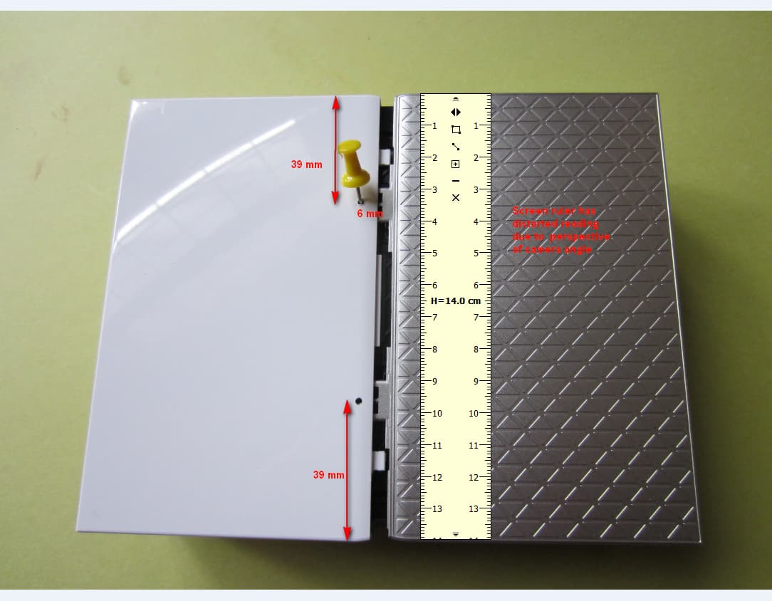

In case you are in the wrong forum, the My Cloud Home (MCH) is the more recent personal cloud storage device which WDC introduced around the June of 2017 and it is a perfectly rectangular box, without the rounded front that is associated with the earliler generation of My Cloud (MC) storage devices. With its introduction, the MCH case was also manufactured to a tighter tolerance and it is no longer feasible to wedge the unit open by sliding a slim edge or card into the seam of the unit. Instead, one or two 1mm holes can be drilled to the depth of 1 mm on one side of the casing and a pin inserted to deform the clip to release the bottom silver case. The exact measurement is 6 mm from the seam between the ivory top and silver bottom case and 39 mm from the opposite ends (please see photo). Prior to pulling the case apart, remember to remove the 4 Phillip head screws hidden under the two gray rubber pads on the bottom silver casing of the MCH. Only one side of the MCH needed to be drilled, on the side opposite from the hard drive and the upper and lower case should pull apart relatively easily after the internal tabs depressed by pins.

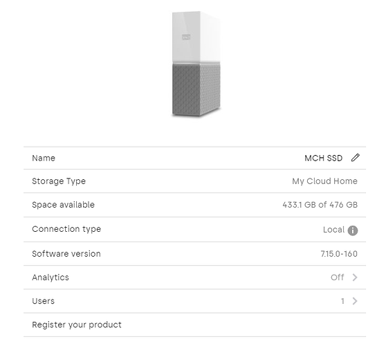

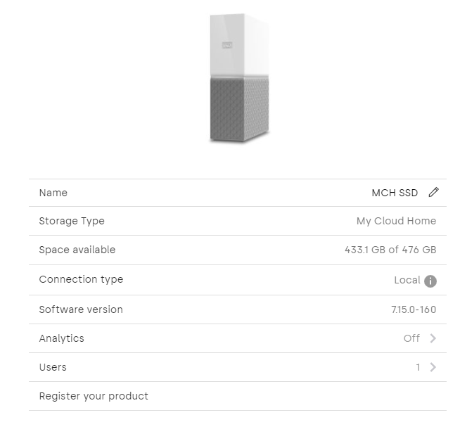

Results: random writes no longer zero
Well, the random writes are no longer zero. One way to look at this is that anything is better than zero, or the random write performance has increased by >=357 times to infinity over zero.
MCHSSDzero_nolonger

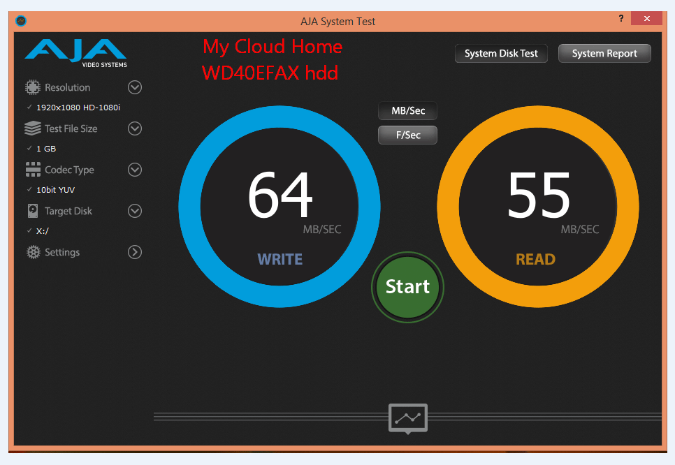

Simple network throughput test of private space on hdd vs ssd:
MCHssd vs wd40
