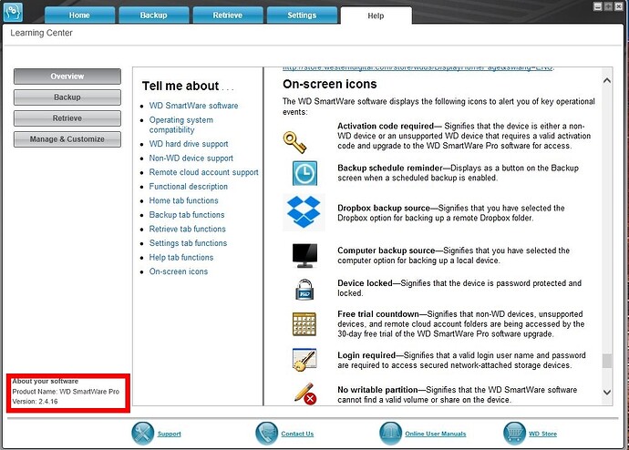

I’m using WD Smartware …(think I have Pro but it doesn’t say PRO) … this is why everyone should know a computer Guy !!

Since you are using SmartWare open it and click on the Help tab for more information and see if you already have pro. See image below. Use this link to download the SmartWare User Manual.
