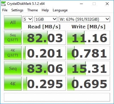

It also helps to use a dedicated disk testing program to give consistent results. Using Crystal Disk Mark (http://crystalmark.info/software/CrystalDiskMark/index-e.html) here is the transfer speed from a wired Gigabit Windows 10 PC to a mapped Toshiba USB 3.0 external hard drive attached to the USB 3.0 port on a first generation My Cloud.
If you are only getting 3 to 7 MB/s transfer speed that may indicate using a USB 2.0 drive or the My Cloud USB port improperly reading the port speed of the attached USB drive. In any case if you use the forum search feature, magnifying glass icon upper right, and search for USB speed you will find the slow speed of the My Cloud USB 3.0 port is a common complaint.
