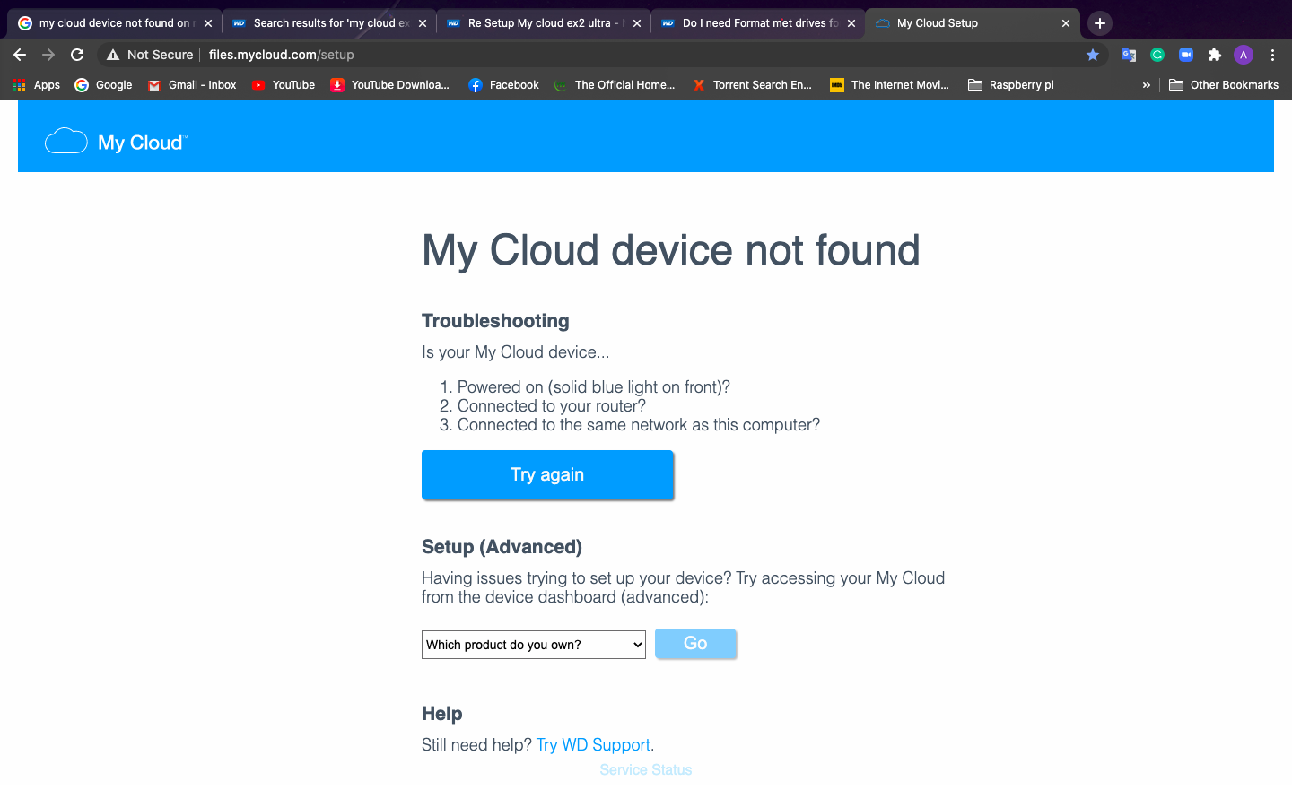

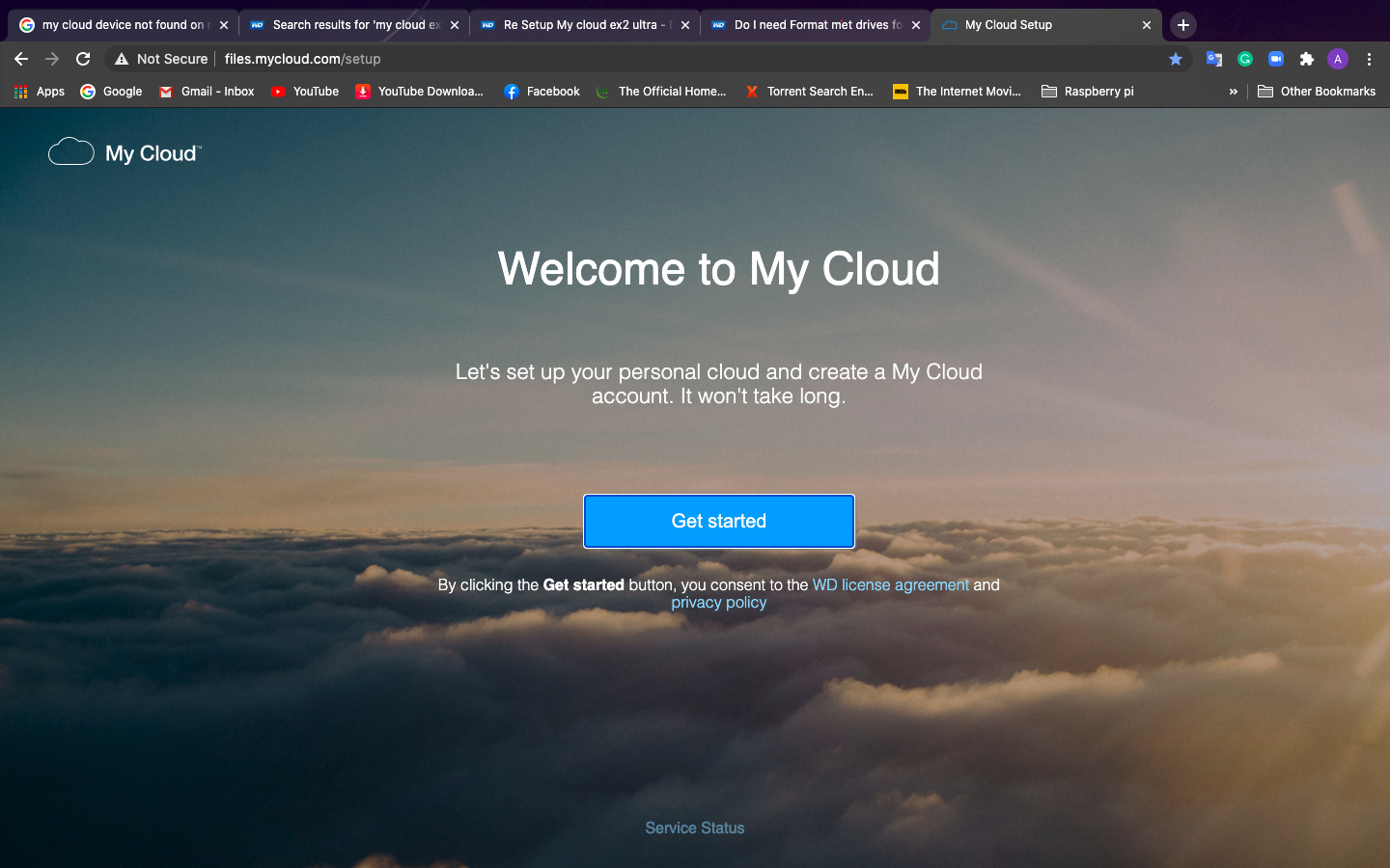

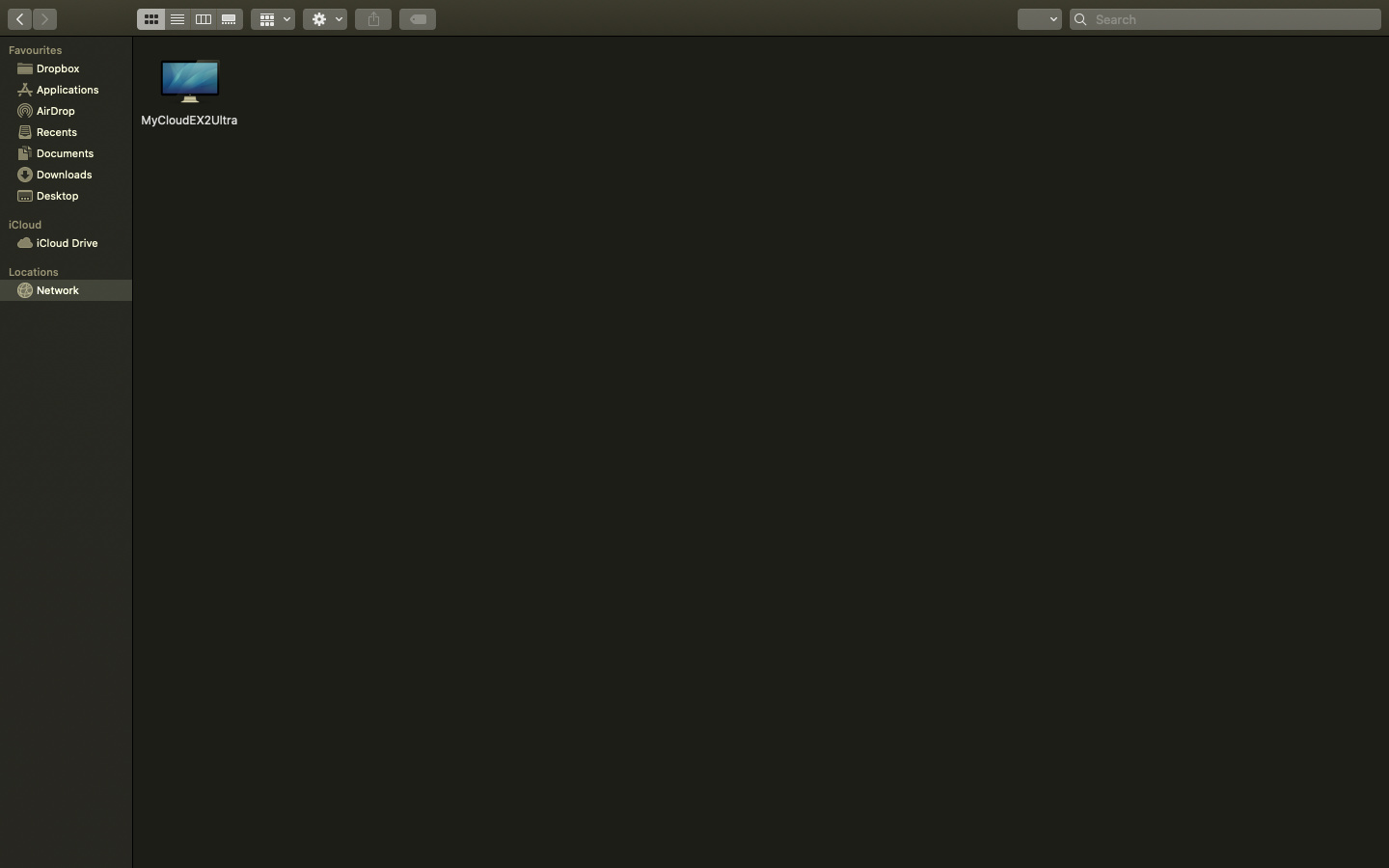

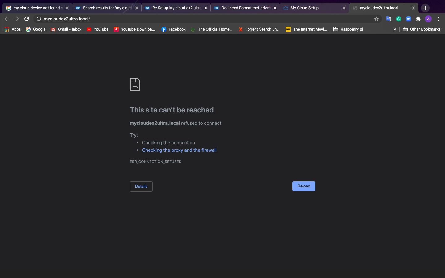

I am sure that it has been discussed many many times on this forum and i did tried a few of the solutions mentioned but failed to detect my cloud.
already did a 5 sec and 40 sec reset.
the power light is solid blue (after some time it pulsates probably because it goes in standby mode)
my hard disk light is solid red since I haven’t set up my hard disk even once.
please let me know any information that is needed. I need help.
I am uploading a few screenshots in order to describe my problem.
Not sure what to tell you at this point. The drive is good, the system is on the EX2 (not the drive) so it looks like a defective EX2. Return it to amazon for a refund.
that is what I am guessing. no return just replacement option available.
have already placed a replacement order hope the next one won’t give me this problem
Something that might interest you… I just tried to connect to my EX2 using the mycloud setup app - no can do. I get the same messages you do. I can access the dashboard through it’s IP address and the content through Advance IP Scanner but not the mycloud setup app. Make of that what you will.
I think you might still have a problem but I’m not sure how you’re going to set up a new mycloud when the app doesn’t appear to be working.

Turns out the device was defective all along. Received a new device today and it begin working in couple of mins only.
