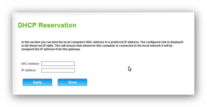

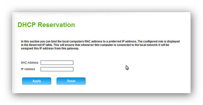

The problem is due to WD Cloud unit fails the IP address after a while.
Start by logging into your router and find out which external devices are connected. Note the IP address and MAC address. (see picture)
Then select the units must have static addresses (see picture)

Restart the WD My Cloud drive (unplug the power and wait 40 seconds, turn the power on.
Wait until the LED is solid blue!
Download the application WD Quick View from the website and install it!
You already have this installed, the warning menu see that the error is due to the wrong IP address.
From here you can log in to the Dashboard and change the network to WD My Cloud unit shall have a static address. Enter the values ​​you wrote down earlier.
Save.
Unfortunately, the text on the photos in Swedish, but you probably know the settings!
values ​​you wrote d own earlier.
Save.
