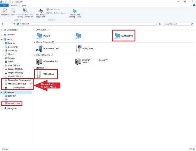

Do you have Quick View and if you do have you tried to map by it? See example image below.
This example shows how I would map using File Explorer.

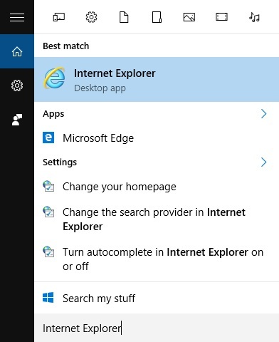

To sign on to mycloud.com I have to use Internet Explorer or another browser, Edge will not work at this time. See example image below for sharing.
Click on, tap or activate image to enlarge it.
