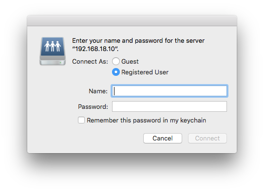

??? Did you save save it to your keychain as guest?
I never select that option, and it always prompts me to enter a username or use guest. If you did save it, delete the keychain. You might also have to “eject” it first.
I get this all the time when I try my suggestion from earlier:
