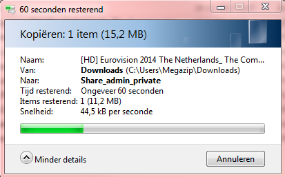

With no reason, i mean i didn’t change anything in my computer or network, i nearly can’t upload a file to MyBookLive 44,5 kb per second. A 15mb file takes 10 minutes to download.
  • Streaming a movie to my computer or television is working fine, no problem at all.

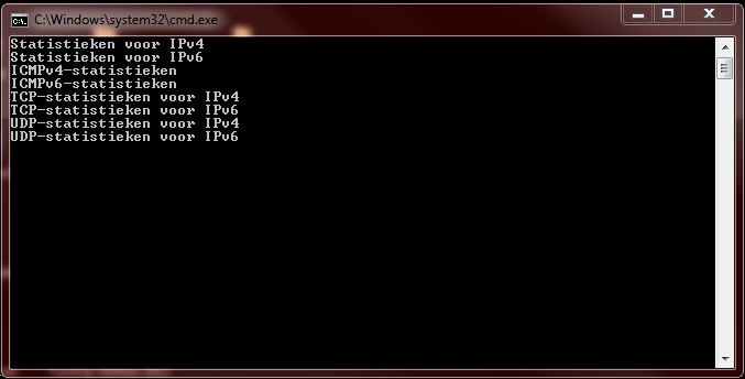

When using that option and uploading a file, i only see this
I expected, as mentioned in the troublshouting text, to see some errors, but nothing happens.
This the speed i get uploading a 15mb file:

Megazip, sorry, but that guide was written expecting English language in the command output.
In the script, see this line:
@netstat -es | findstr /C:Error /C:IP /C:Retra /C:ICMP
Chage /C:Error  and  /C:Retra
to the translated words  (Retra means Retransmission)
@netstat -es | findstr /C:xxxxx /C:IP /C:yyyyy /C:ICMP

I tried to translate the words to Dutch, but i guess they are not the right translation.
Is there a way to find the files somewhere on my computer?
Thanks!
Cut and paste the entire output of the command
netstat -es
