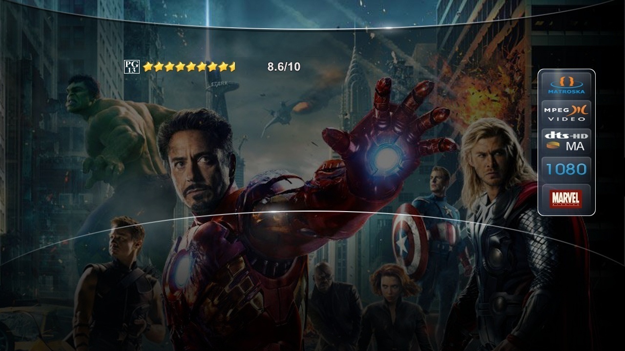

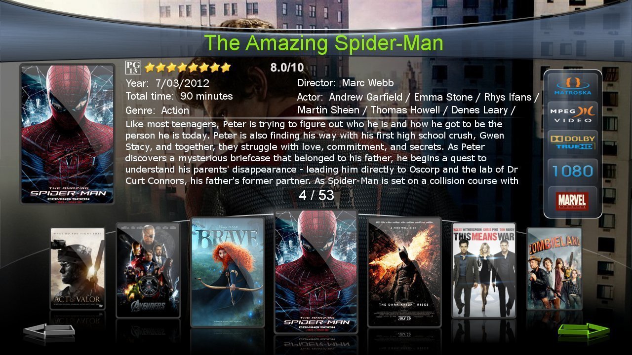

If you are, the Movie information is not “Hard Coded” on the Moviesheet. The Movie Info is displayed via Metadata XML
If you’re getting “Double Text” then you’re using a Moviesheet which has hardcoded info on it (Which then is… not a Mojo Moviesheet)
eg. This “Mojo” Screenshot is displaying all the info from the Metadata contained in the Movie XML file
The “Mojo” Moviesheets you should be generating should look like this…
(No Hard Coded movie information)

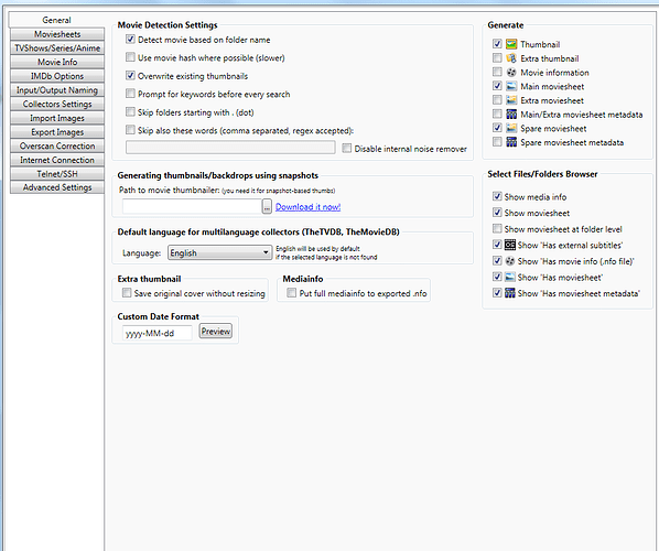

The 1ST Moviesheet you are Generating is a “Default Thumbgen” Moviesheet … (Nothing to do with Mojo Theme)
So No, you should Not be creating / using this Moviesheet with the “Mojo” Theme
The 2ND Moviesheet (Mojo Glass) is the Correct one (and only one) you should be creating and using with “Mojo” Theme
Mojo Glass should be set in Thumbgen as your “Main Moviesheet”

Thanks Joey, Got that sorted, but the covers are not showing now, is there a setting I am missing in Thumbgen?
eg
Ignore the fact the backdrop hasn’t loaded…I was a bit fast with the snapshot…it does load for all titles but I am only getting the film reel icon instead of covers, and here is a snapshot of the “Up” folder with metadata and movie files…
And here is a snapshot of my Thumbgen options showing moviesheet and extra moviesheet and thumbnails
So the spare moviesheet is generated using the TW No Cover for smp template as per Tinwarble’s instructions, and the main moviesheet contains the background which then gets the xml written onto it.
Thanks again for your time and patience, once I have this sorted I can go through my collection building the sheets for my new present :slight_smile:

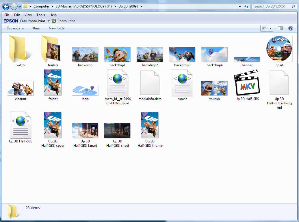

you need to have a thumbnail for UP 3D-Half SBS.mkv
(the Extra Moviesheet is used for the Reflection Thumbnails if you wish to have them. If you wish to have normal thumbs… just untick the box… but keep the Thumbnail box ticked and make sure $M$N   … nothing else after this code)
Will not display
As per the guide you must have the 4 files in red
If you dont, Double check the input/output naming
Thanks Joey, somehow my settings had sent the cover as a spare sheet outside the movie folder, so it’s all good now. Appreciate your help
