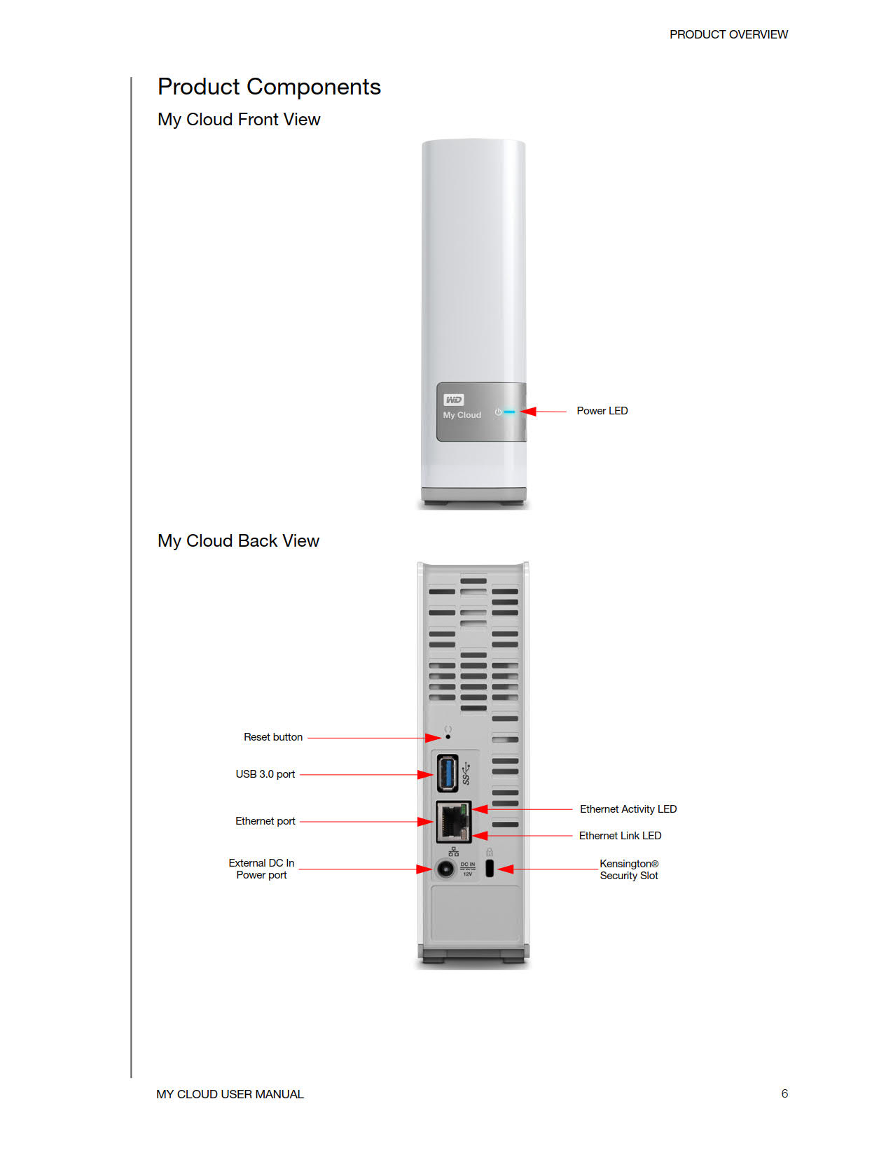

Should the green and orange be lighted when I put the ethernet cable?

Generally yes, both LED’s on the network port on the My Cloud should light up when an Ethernet wire is connected from a router to the My Cloud.

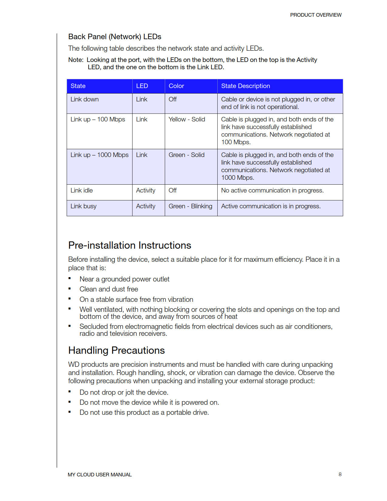

If one looks at the My Cloud User Manual (https://support.wdc.com/product.aspx?ID=904) they’ll see diagrams that indicates what each LED light is for on the Ethernet port. For example from the single bay My Cloud v2.x user manual:
No. The lower LED (Ethernet Link) should be static:
off indicates a fault in the Ethernet connection (somewhere)
yellow indicates a 100Mbps link has been established
green indicates a 1Gbps link has been established.
If the lower LED is changing, something is wrong.
Try unplugging & re-plugging the cable at both ends.
Try replacing the cable.
Try a different port on the router.
The upper LED (Ethernet Activity) should flicker intermittently, indicating traffic is being passed over the link.
