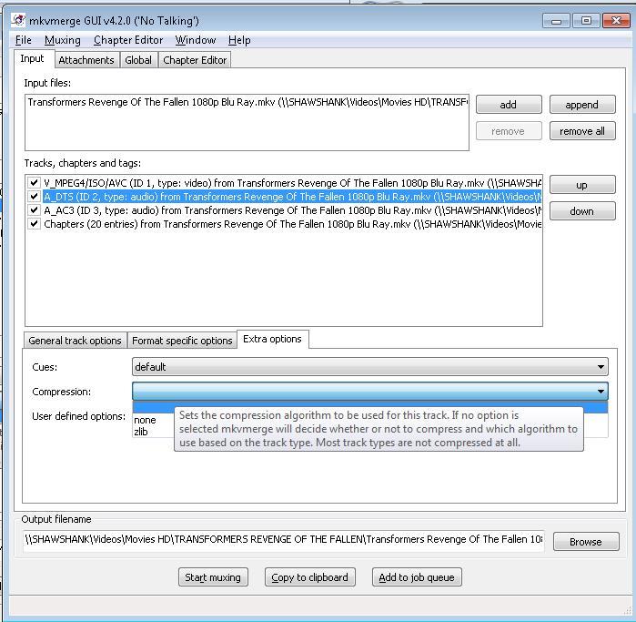

Step 3:
Launch the “mkvmerge GUI” (This shortcut should appear after installation, it will ask you during installation if you want to place a shortcut make sure to check it, otherwise go to you programes list and run it)
Step 4:
Click “Add” and choose the movie that have the problem (The MKV file) then press “open”.
You will see at the bottom that the “Output filename” is containing an additional “(1)” you can change it to any name you want.
Then under “Tracks, chapters and tags” you see a list of your videos/sounds/text that are attached to the movie you have just added.
Click on the first one then go to “Extra options” tab and click it, from the “Compression” list choose “none” that’s it.
Do the same for every line in the “Tracks, chapters and tags” list.
Step 5:
Click “Start muxing” button. and wait until finish.
