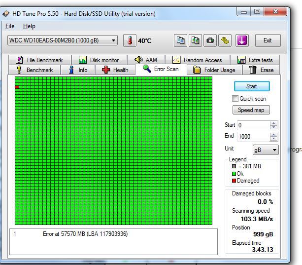

I ran HDtune  full test and  it passed.  Then did SMART and  warning is gone and the error count has NOT increased.
How llong would it take to know if this disk is going to fail or throw up errors later? Am I fixed and can trust this drive?
Could those 2011 errors all occured when Iw as trying to save the existing OS and doing chckdisk boot repairs and such?  In other words, how likely is it that  that many errors could occur when the drive was having issues accessing the OS?
