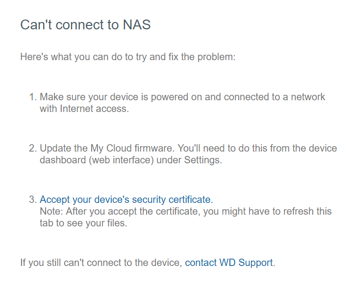

All of a sudden my NAS has become inaccessible via web browser. However, I’m still able to access the device by my network and Mobile/Tablet devices?
When I try to access the NAS through https://files.mycloud.com it gives me the error: https://i.gyazo.com/f1dd0b42bd916514e7d69f0d07c8109b.png and it says my NAS is ‘offline’ which isn’t the case.
I’ve checked my settings and nothing has changed. I used to be able to log into the device fine previously.
Can someone please advise what to do? (I have followed the instructions on that image, firmware is up to date, NAS reset etc)

I’ve just received an email back from WD’s customer support and by following their advice restored access to my NAS via web browser
All I had to do was power off the device, upon rebooting, hold the reset button in for 40 seconds and this restored the default settings to the device without removing or altering my files located on there.
